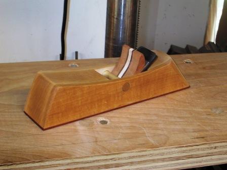

Check out my first build.
It's a wooden plane made from maple and fitted with a Hock iron and chipbreaker. I've been reading David Fink's book on "Making and Mastering Wood Planes" for the past month. I decided to buy a kit from Ron Hock before tackling the whole thing from scratch. It worked out quite well from a design and ergonomic stantpoint but most surprisingly, the functional perspective. After spending a bit of time optimizing the blade opening the plane effortlessly makes curls thin, even and long. It's as good as anything I have in my current armamentarium.
I'm looking forward to making more models from scratch using some less common woods.
I'd be interested if there's anyone here with some experience in making wood planes.

JJ - Great job! I built a block plane some time back and use it a lot, but its far too beat up to warrant any pictures really. I need to find the time to build a new set of planes. Thanks for posting this.jfrench38824.6769328704

JJ...I've got the same book, and it's on my short list of things to do. My plan is to make a jointer plane--something I couldn't afford otherwise. Good job, BTW!
PostPosted: Mon Apr 17, 2006 9:15 am
Posts: 457
Do I see a little leftover piece of a neck laminate in there?
Looks good. I bought a Steve Knight jointer plane which is very nice and got me thinking, why can't I make that? You have just made me put that on my list of things to do. Thanks JJ!!!

Good eye on the wedge, Frank. I've got so much of that stripey scrap left over from making necks...I'm always looking for new uses.
Those Knight planes are a thing of beauty. I looked at his site for some time while I was scoping out plane info. You're right...you can make any of those planes. I am amazed at how well this light smoothing plane works. I'd like to make a few different sizes... especially a low-angle jack plane for thinning high-zoot backs and sides.

Cool! How's the tap tone? Binding? Finish?
Really nice plane, JJ. Ron's a great guy isn't he?
